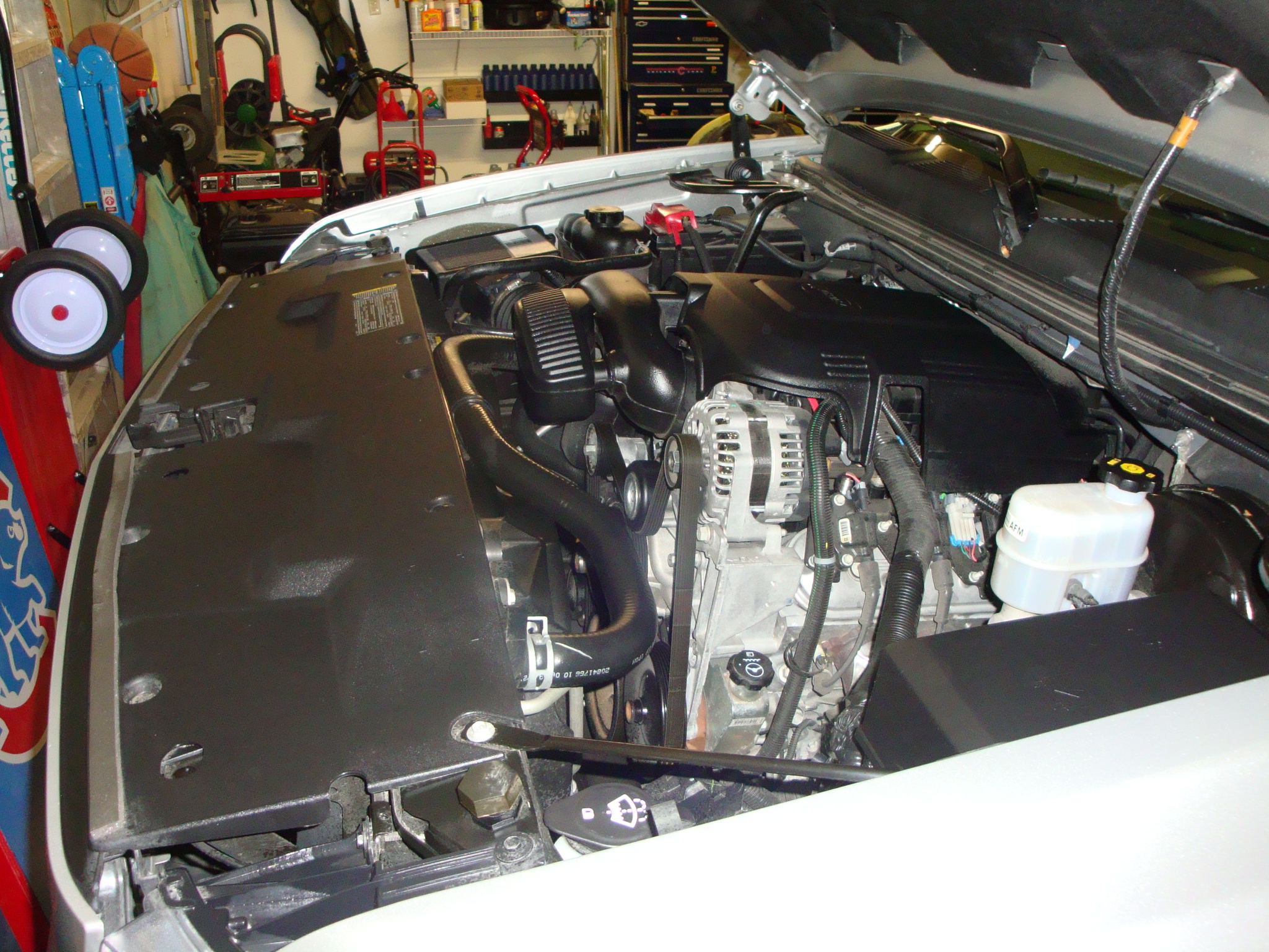

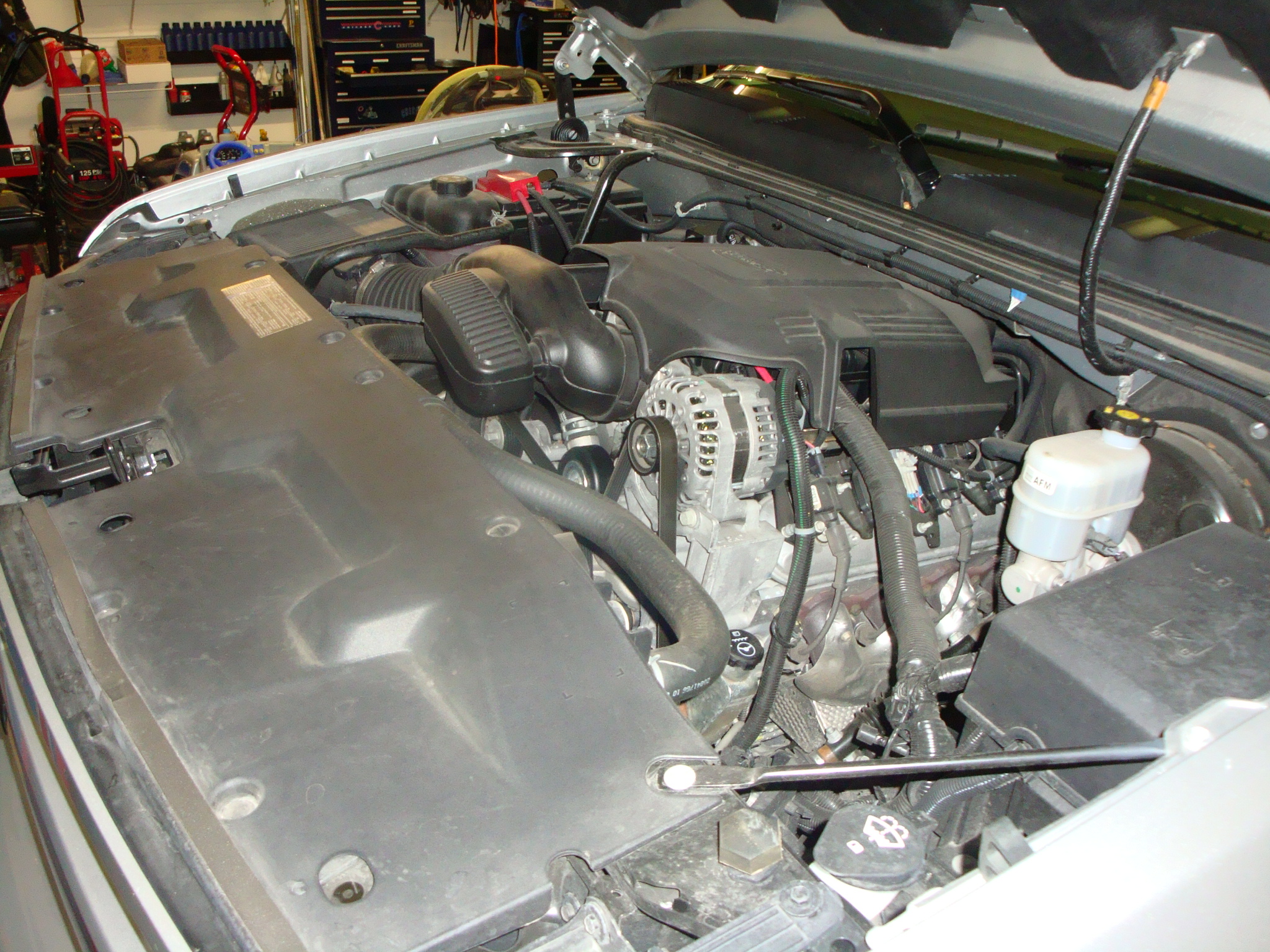

I did mine all by hand (no hose)
what did you use? and what diden't you touch?
I normally just take a cloth and brush and give it a bit of a scrubbing, and stay away from the electrical components. A clean engine also makes a nice work environment when you have to get some thing done.
Mainly just did the plastic and rubber pieces. Used some orange degreaser and a few rags.
I also used some stoners tire spray on a rag for the plastic and rubber pieces.
And since I did the engine this past summer it has stayed relatively clean. NO the tire spray has not attracted any dust.
